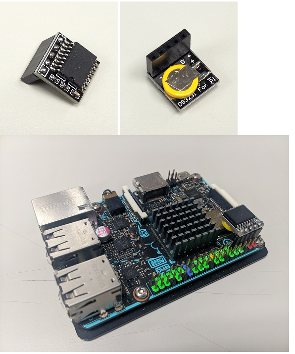

发表于 2018-9-29 18:23:05 | 显示全部楼层 |阅读模式
1,添加DS3231硬件
2,软件修改如下教程
https://tinkerboarding.co.uk/wiki/index.php/DS3231
  1. diff --git a/arch/arm/boot/dts/rk3288-miniarm.dts b/arch/arm/boot/dts/rk3288-miniarm.dts
  2. index 88fde1f..0ff7a33 100755
  3. --- a/arch/arm/boot/dts/rk3288-miniarm.dts
  4. +++ b/arch/arm/boot/dts/rk3288-miniarm.dts
  5. @@ -596,6 +596,10 @@
  6. &i2c1 {
  7.         status = "okay";
  8. +        rtc: ds1307@68 {
  9. +                compatible = "dallas,ds1307";
  10. +                reg = <0x68>;
  11. +        };
  12. };
  13. &i2c3 {
  14. diff --git a/arch/arm/configs/miniarm-rk3288_defconfig b/arch/arm/configs/miniarm-rk3288_defconfig
  15. index d372ebc..7316d43 100755
  16. --- a/arch/arm/configs/miniarm-rk3288_defconfig
  17. +++ b/arch/arm/configs/miniarm-rk3288_defconfig
  18. @@ -778,3 +778,4 @@ CONFIG_TEXTSEARCH_BM=y
  19. CONFIG_TEXTSEARCH_FSM=y
  20. CONFIG_PPS_CLIENT_GPIO=y
  21. CONFIG_POSIX_MQUEUE=y
  22. +CONFIG_RTC_DRV_DS1307=m

发表于 2018-11-19 10:27:43 来自手机 | 显示全部楼层
请问怎么添加?有tinkerboards的原理图和丝印图吗?android需要修改吗
