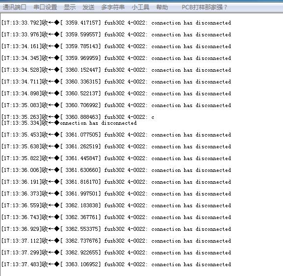

嗨,各位:
       我刚买了个Rk3399 ,刷完固件后,连接typec 线,发现adb 端口一直没出来,打开串口发现 fusb报错。
请问下,这个是啥原因?是我刷的固件不对吗?
[17:13:35.453]收←◆[ 3361.077505] fusb302 4-0022: connection has disconnected
[17:13:35.638]收←◆[ 3361.262519] fusb302 4-0022: connection has disconnected
[17:13:35.822]收←◆[ 3361.445847] fusb302 4-0022: connection has disconnected
[17:13:36.006]收←◆[ 3361.630660] fusb302 4-0022: connection has disconnected
[17:13:36.191]收←◆[ 3361.816170] fusb302 4-0022: connection has disconnected
[17:13:36.373]收←◆[ 3361.997501] fusb302 4-0022: connection has disconnected
[17:13:36.559]收←◆[ 3362.183838] fusb302 4-0022: connection has disconnected

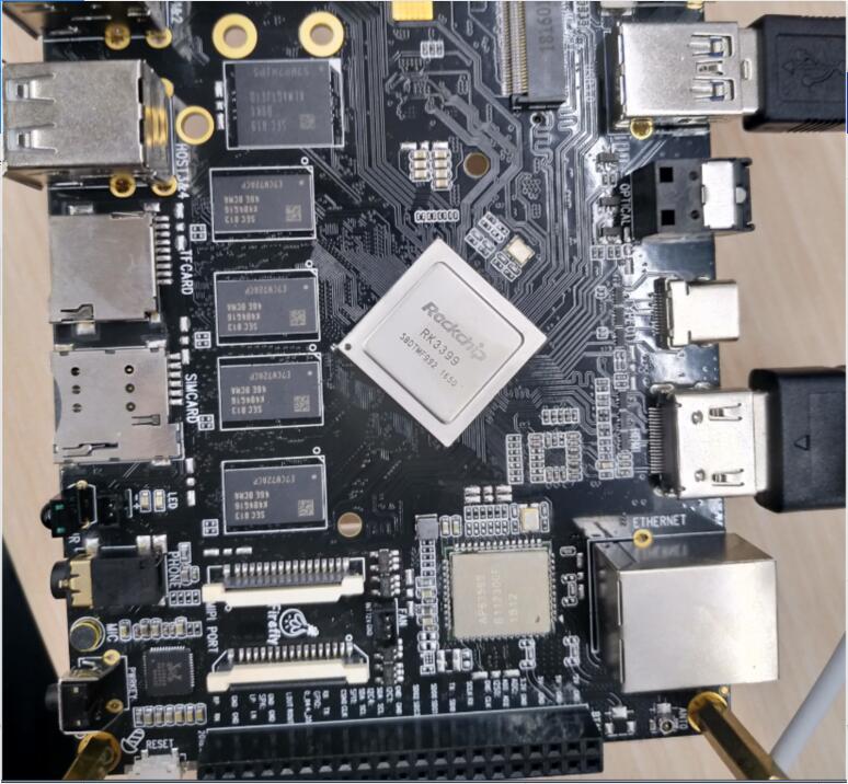

发表于 2018-9-12 18:02:15 | 显示全部楼层
你用的具体型号是啥?实物拍照连线看看
21
21
 楼主| 发表于 2018-9-12 18:16:44 | 显示全部楼层
嗨,型号是 RK3399 SBDTMF992 1650      是这个吗?
21
21
 楼主| 发表于 2018-9-12 18:21:58 | 显示全部楼层
风火轮用户36502 发表于 2018-9-12 18:02
你用的具体型号是啥?实物拍照连线看看
你看看我的附件,能不能看到你需要的信息
rk3399 设备拍照
rk3399 设备拍照

[15:54:45.643]收←◆[    2.717136] asoc-simple-card rt5640-sound: rt5640-aif1 <-> ff890000.i2s mapping ok
[    2.725674] mmc2: queuing unknown CIS tuple 0x80 (2 bytes)
[    2.726471] input: rockchip,rt5640-codec Headphone Jack as /devices/platform/rt5640-sound/sound/card0/input1
[    2.727837] mmc2: queuing unknown CIS tuple 0x80 (3 bytes)
[    2.729740] mmc2: queuing unknown CIS tuple 0x80 (3 bytes)
[    2.731431] asoc-simple-card spdif-sound: dit-hifi <-> ff870000.spdif mapping ok
[    2.733131] mmc2: queuing unknown CIS tuple 0x80 (7 bytes)
[    2.736318] rk-hdmi-dp-sound hdmi-dp-sound: control 3:0:0:ELD:0 is already present
[    2.736448] hdmi-audio-codec hdmi-audio-codec.10.auto: ASoC: Failed to add ELD: -16
[    2.738191] rk-hdmi-dp-sound hdmi-dp-sound: multicodec <-> ff8a0000.i2s mapping ok
[    2.738424] hdmi-audio-codec hdmi-audio-codec.10.auto: ASoC: Failed to create Playback debugfs file
[    2.743252] rk808-rtc rk808-rtc: setting system clock to 2013-01-18 08:50:04 UTC (1358499004)
[    2.744858] It doesn't contain Rogue gpu
[15:54:45.708]收←◆[    2.781656] ret 1024
[    2.782748] I : [File] : drivers/gpu/arm/mali400/mali/linux/mali_kernel_linux.c; [Line] : 415; [Func] : mali_module_init(); svn_rev_string_from_arm of this mali_ko is '-063a325', rk_ko_ver is '5', built at '19:13:34', on 'Aug  2 2018'.
[    2.783996] Mali: Mali device driver loaded
[    2.785683] input: rk29-keypad as /devices/platform/rockchip-key/input/input2
[    2.787800] ALSA device list:
[    2.787944]   #0: rockchip,rt5640-codec
[    2.787963]   #1: ROCKCHIP,SPDIF
[    2.787980]   #2: rk-hdmi-dp-sound
[    2.789175] Freeing unused kernel memory: 832K
[    2.794196] mmc_host mmc2: Bus speed (slot 0) = 200000000Hz (slot req 208000000Hz, actual 200000000HZ div = 0)
[    2.801002] init: init first stage started!
[    2.801882] init: Using Android DT directory /proc/device-tree/firmware/android/
[    2.810720] fusb302 4-0022: connection has disconnected
[15:54:45.814]收←◆[    2.887641] usb 3-1: new full-speed USB device number 2 using xhci-hcd
[    2.899480] fec: <1> error: get_squashfs_size: failed to parse superblock: Invalid argument
[    2.899684] init: [libfs_mgr]Failed to get verity metadata '/dev/block/by-name/system': No such file or directory
[    2.901054] init: Failed to setup verity for '/system': No such file or directory
[    2.901286] init: Failed to mount required partitions early ...
[    2.901441] init: panic: rebooting to bootloader
[    2.901678] init: Reboot start, reason: reboot, rebootTarget: bootloader
[    2.901942] init: android::WriteStringToFile open failed: No such file or directory
[    2.902229] init: Shutdown timeout: 6000 ms
[    2.902406] init: terminating init services
[    2.902598] init: waitid failed: No child processes
[    2.902831] init: Terminating running services took 1ms with remaining services:0
[    2.903048] init: waitid failed: No child processes
[    2.903270] init: vold not running, skipping vold shutdown
[15:54:45.931]收←◆[    3.004778] init: powerctl_shutdown_time_ms:102:0
[    3.004963] init: Reboot ending, jumping to kernel
[    3.005096] cpu4 limit freq=816000 min=816000 max=816000
[    3.006969] cpu0 limit freq=816000 min=816000 max=816000
[    3.009170] usb 3-1: New USB device found, idVendor=222a, idProduct=0001
[    3.009206] usb 3-1: New USB device strings: Mfr=1, Product=2, SerialNumber=0
[    3.009218] usb 3-1: Product: ILITEK-TP
[    3.009230] usb 3-1: Manufacturer: ILITEK
[    3.028635] input: ILITEK ILITEK-TP as /devices/platform/usb@fe900000/fe900000.dwc3/xhci-hcd.12.auto/usb3/3-1/3-1:1.0/0003:222A:0001.0001/input/input3
[15:54:46.007]收←◆[    3.081615] hid-multitouch 0003:222A:0001.0001: input,hiddev0,hidraw0: USB HID v1.10 Mouse [ILITEK ILITEK-TP] on usb-xhci-hcd.12.auto-1/input0
[    3.096802] dwmmc_rockchip fe310000.dwmmc: Successfully tuned phase to 247
[    3.101388] mmc2: queuing unknown CIS tuple 0x91 (3 bytes)
[    3.101907] mmc2: new ultra high speed SDR104 SDIO card at address 0001
[    3.117663] rk-vcodec ff660000.rkvdec: vcodec shutdown
[    3.118130] rk-vcodec ff650000.vpu_service: vcodec shutdown
[    3.118965] rk808->stby_gpio(56)=low
[    3.119326] rk808->hold_gpio(45)=low
[15:54:46.080]收←◆[    3.153887] fusb302 4-0022: connection has disconnected
[    3.159645] random: nonblocking pool is initialized
[15:54:46.246]收←◆[    3.320215] reboot: Restarting system with command 'bootloader'
[15:54:46.293]收←◆DDR Version 1.12 20180518
In
soft reset
SRX
Channel 0: DDR3, 800MHz
Bus Width=32 Col=10 Bank=8 Row=15 CS=1 Die Bus-Width=16 Size=1024MB
Channel 1: DDR3, 800MHz
