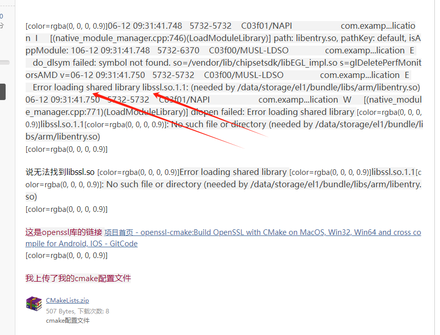

创建项目后,使用Arkts + native C++来进行开发,不添加任何额外的第三方库的时候RegisterEntryModule函数是可以被正常加载的,但是只要我再cpp文件中添加了第三方库就会出问题了,就会导致RegisterEntryModule函数不会被正常加载.我就添加了一个OpenSSl的库,然后运行后日志一直提示
[color=rgba(0, 0, 0, 0.9)]06-12 09:31:41.748   5732-5732    C03f01/NAPI                    com.examp...lication  I     [(native_module_manager.cpp:746)(LoadModuleLibrary)] path: libentry.so, pathKey: default, isAppModule: 106-12 09:31:41.748   5732-6370    C03f00/MUSL-LDSO               com.examp...lication  E     do_dlsym failed: symbol not found. so=/vendor/lib/chipsetsdk/libEGL_impl.so s=glDeletePerfMonitorsAMD v=06-12 09:31:41.750   5732-5732    C03f00/MUSL-LDSO               com.examp...lication  E     Error loading shared library libssl.so.1.1: (needed by /data/storage/el1/bundle/libs/arm/libentry.so)06-12 09:31:41.750   5732-5732    C03f01/NAPI                    com.examp...lication  W     [(native_module_manager.cpp:771)(LoadModuleLibrary)] dlopen failed: Error loading shared library [color=rgba(0, 0, 0, 0.9)]libssl.so.1.1[color=rgba(0, 0, 0, 0.9)]: No such file or directory (needed by /data/storage/el1/bundle/libs/arm/libentry.so)
说无法找到libssl.so [color=rgba(0, 0, 0, 0.9)]Error loading shared library [color=rgba(0, 0, 0, 0.9)]libssl.so.1.1[color=rgba(0, 0, 0, 0.9)]: No such file or directory (needed by /data/storage/el1/bundle/libs/arm/libentry.so)

发表于 2025-6-13 14:20:19 | 显示全部楼层
你好!可能是动态库缺失了。
可以尝试将openssl编译为静态库再链接到.so文件中
