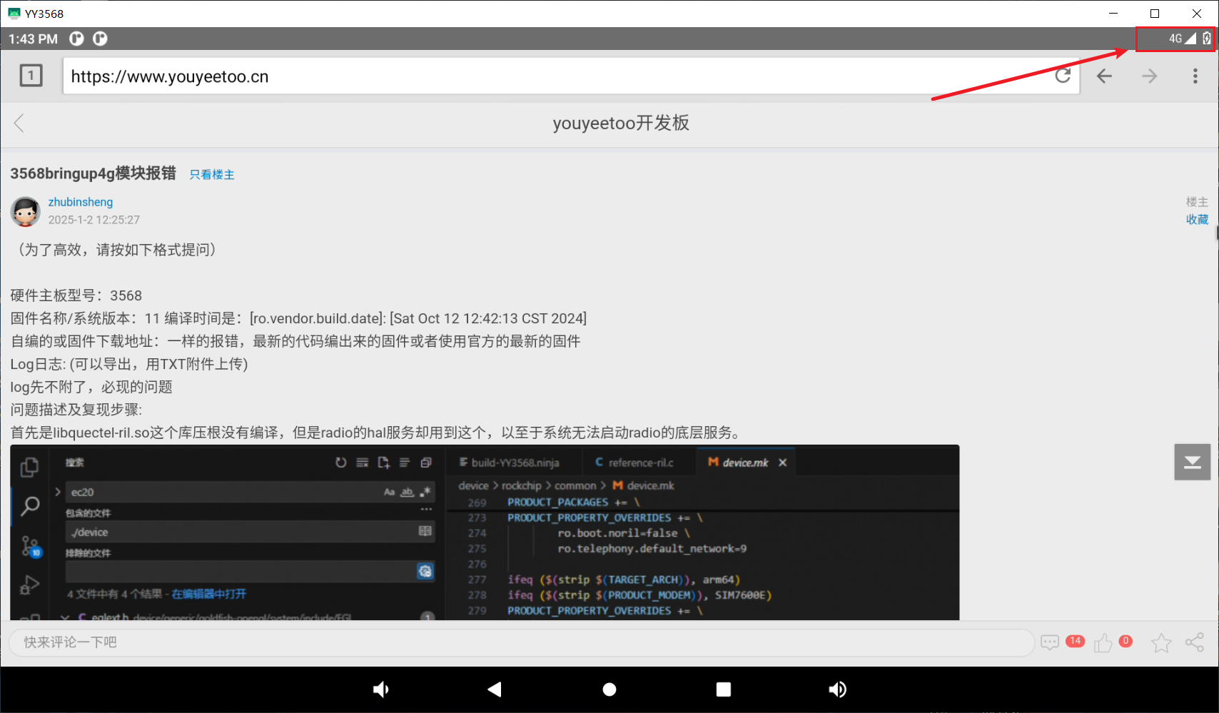

发表于 2025-1-2 12:25:27 | 显示全部楼层 |阅读模式
提示: 作者被禁止或删除 内容自动屏蔽

 楼主| 发表于 2025-1-2 15:13:02 | 显示全部楼层
提示: 作者被禁止或删除 内容自动屏蔽

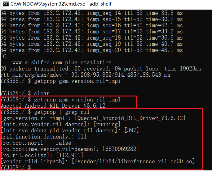

发表于 2025-1-9 15:03:32 | 显示全部楼层
您好!
1.将configure.rar解压后配置文件放到vendor/rockchip/common/phone下,位置如下所示
  bin/chat
  etc/ppp/ip-down
  etc/ppp/ip-up
  etc/ppp/ql-ril.conf
  lib/libreference-ril-ec20.so
2.device/rockchip/common打入devicecommon.patch
3.device/rockchip/rk356x打入devicerk356x.patch
4.vendor/rockchip/common打入vendorcommon.patch
5.hardware/ril/rild/rild.rc
diff --git a/rild/rild.rc b/rild/rild.rc
index f6beb54..7a2572f 100644
--- a/rild/rild.rc
+++ b/rild/rild.rc
@@ -1,5 +1,5 @@
service vendor.ril-daemon /vendor/bin/hw/rild
     class main
-    user radio
-    group radio cache inet misc audio log readproc wakelock
+    user root
+    group radio cache inet misc audio sdcard_rw log
     capabilities BLOCK_SUSPEND NET_ADMIN NET_RAW
modify.rar
271.79 KB, 下载次数: 5965
54
827
827
发表于 2025-1-9 15:13:55 | 显示全部楼层
1.kernel/打入kerneldriver.patch
2./system/core/init/devices.cpp修改如下
diff --git a/init/devices.cpp b/init/devices.cpp
index 9fbec641b..9fca78432 100644
--- a/init/devices.cpp
+++ b/init/devices.cpp
@@ -492,6 +492,11 @@ void DeviceHandler::HandleUevent(const Uevent& uevent) {
             int device_id = uevent.minor % 128 + 1;
             devpath = StringPrintf("/dev/bus/usb/%03d/%03d", bus_id, device_id);
+                               #if 1 //add by quectel for mknod /dev/cdc-wdmo
+                                       } else if (uevent.subsystem == "usbmisc" && !uevent.device_name.empty()) {
+                                                          devpath = "/dev/" + uevent.device_name;
+                               #endif
     } else if (StartsWith(uevent.subsystem, "usb")) {
         // ignore other USB events
         return;
kerneldriver.rar
19.21 KB, 下载次数: 5843
drivermodify

发表于 2025-1-13 11:14:51 | 显示全部楼层
拉了一套全新源码测试修改的,编译测试烧录通过才放出来,你那边测试没通过?libreference-ril-ec20.so可以重命名为libquectel-ril.so,可以通过命令查询库详细信息
