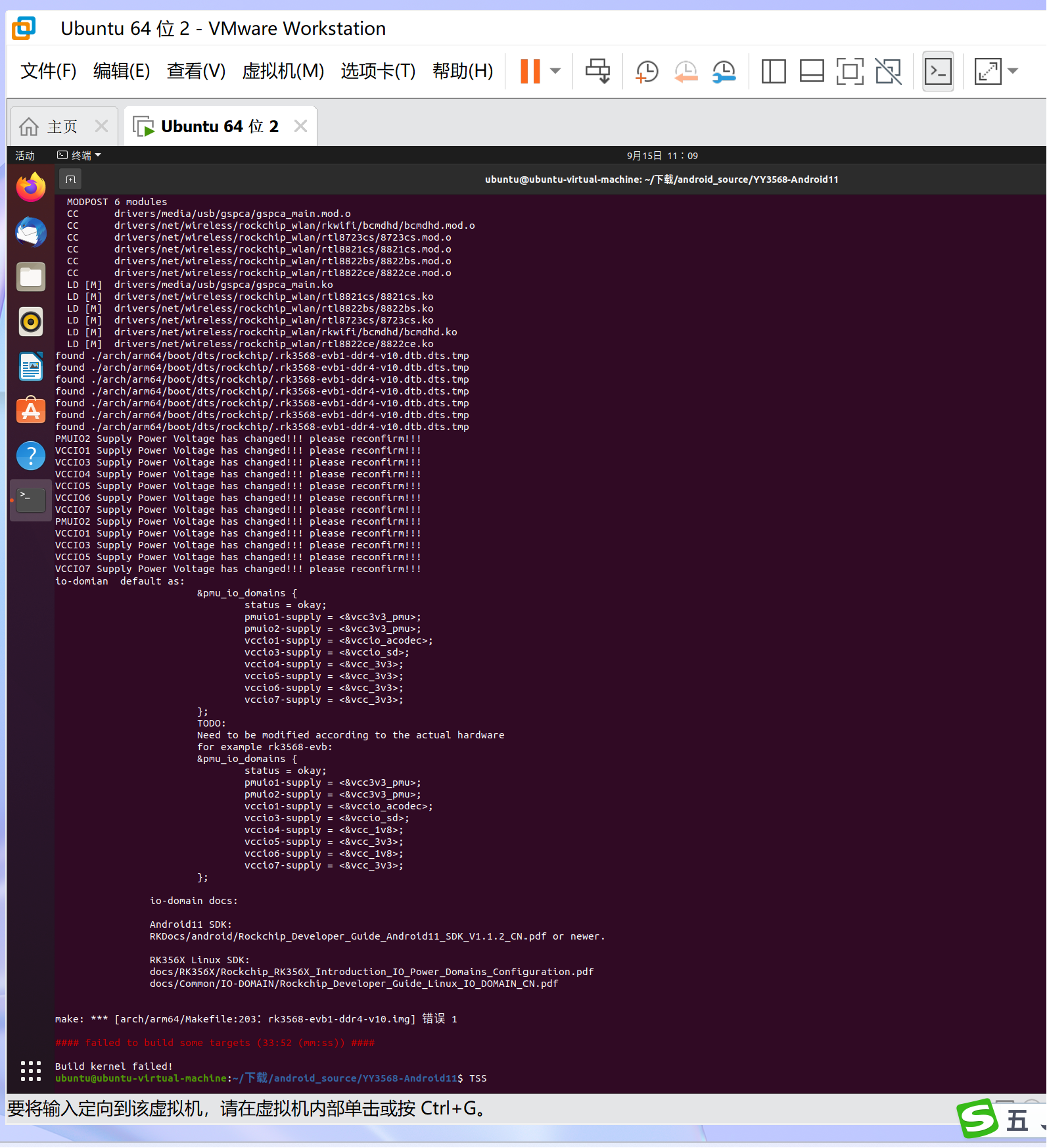

 楼主| 发表于 2023-9-15 11:11:04 | 显示全部楼层
编译结果如图

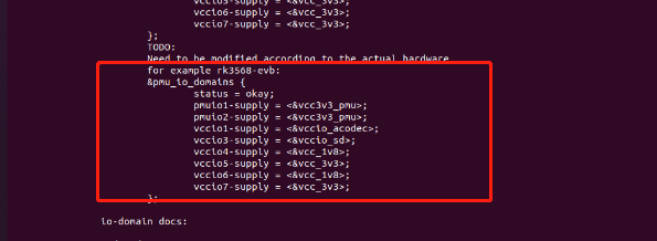

发表于 2023-9-15 17:05:35 | 显示全部楼层
按照这个选

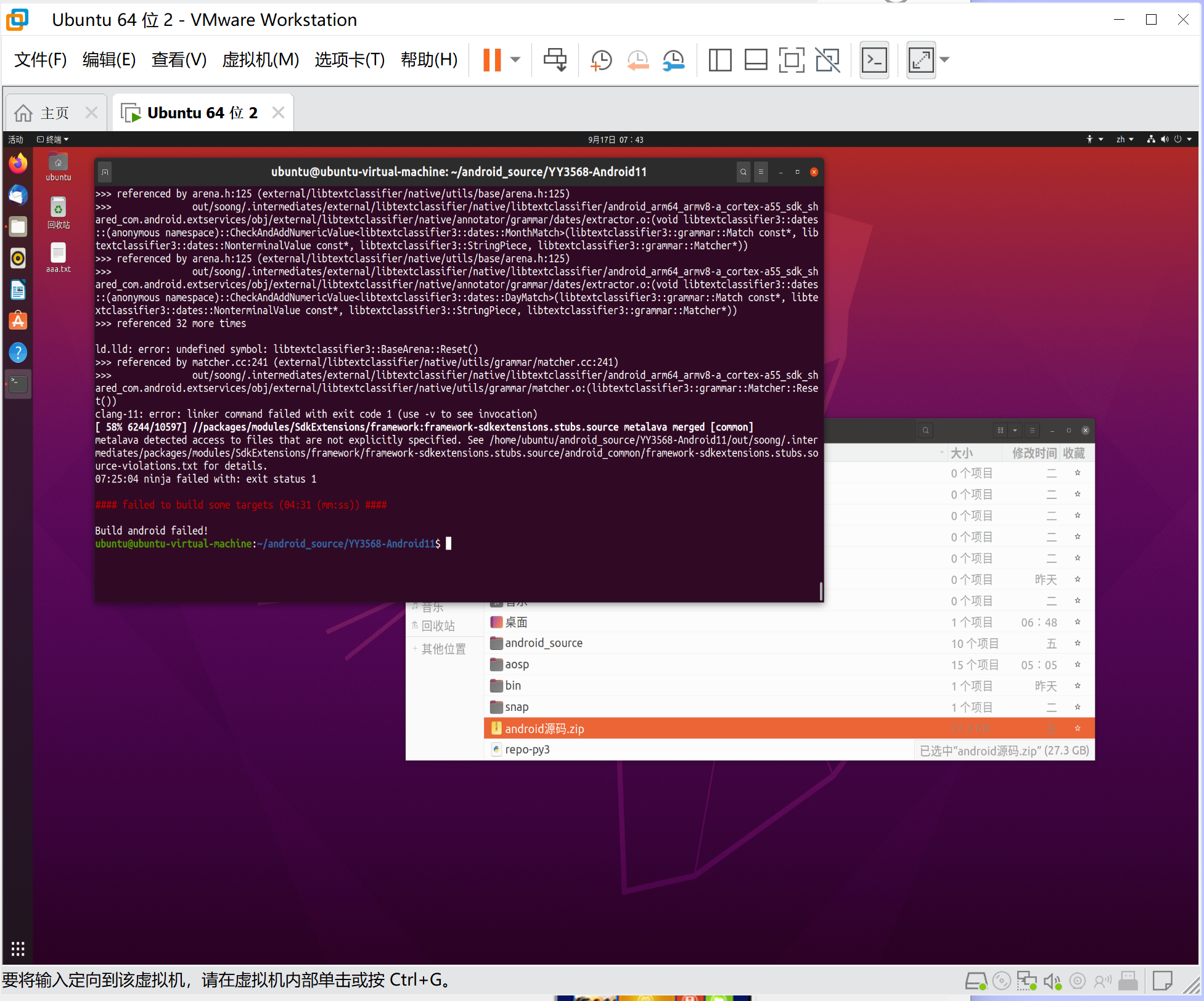

 楼主| 发表于 2023-9-17 07:45:15 | 显示全部楼层
发表于 2023-9-18 09:15:29 | 显示全部楼层
你这虚拟机物理内存加交换内存是多少,你用docker环境进行编译试一下,还不行的话,你联系客服远程看一下

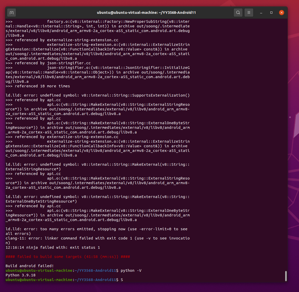

 楼主| 发表于 2023-9-20 17:42:03 | 显示全部楼层
ld.lld: error: undefined symbol: v8::internal::String::SupportsExternalization()
>>> referenced by api.cc
>>>               api.ov8::String::MakeExternal(v8::String::ExternalStringReso
urce*)) in archive out/soong/.intermediates/external/v8/libv8/android_arm_armv8-
2a_cortex-a55_static_com.android.art.debug/libv8.a
>>>               api.ov8::String::MakeExternal(v8::String::ExternalOneByteStr
ingResource*)) in archive out/soong/.intermediates/external/v8/libv8/android_arm
_armv8-2a_cortex-a55_static_com.android.art.debug/libv8.a
>>> referenced by externalize-string-extension.cc
>>>               externalize-string-extension.ov8::internal::ExternalizeStrin
gExtension::Externalize(v8::FunctionCallbackInfo<v8::Value> const&)) in archive
out/soong/.intermediates/external/v8/libv8/android_arm_armv8-2a_cortex-a55_stati
ld.lld: error: undefined symbol: v8::internal::String::MakeExternal(v8::String::
ExternalStringResource*)
ExternalOneByteStringResource*)
ld.lld: error: too many errors emitted, stopping now (use -error-limit=0 to see
all errors)
clang-11: error: linker command failed with exit code 1 (use -v to see invocatio
n)
12:16:14 ninja failed with: exit status 1
#### failed to build some targets (41:58 (mm:ss)) ####
Build android failed!

 楼主| 发表于 2023-9-20 17:43:19 | 显示全部楼层
风火轮用户68631 发表于 2023-9-18 09:15
你这虚拟机物理内存加交换内存是多少,你用docker环境进行编译试一下,还不行的话,你联系客服远程看一下 ...
虚拟机物理内存16GB,交接内存32GB

 楼主| 发表于 2023-9-20 17:45:24 | 显示全部楼层
编译失败
